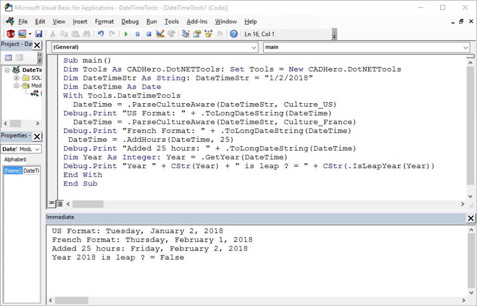

2. Working with Date and Time has never been this easy. You can even parse string dates into a culture aware VBA Date object.
<p>Sub main()</p><p>Dim Tools As CADHero.DotNETTools: Set Tools = New CADHero.DotNETTools</p><p>Dim DateTimeStr As String: DateTimeStr = "1/2/2018"</p><p>Dim DateTime As Date</p><p>With Tools.DateTimeTools</p><p>  DateTime = .ParseCultureAware(DateTimeStr, Culture_US)</p><p>Debug.Print "US Format: " + .ToLongDateString(DateTime)</p><p>  DateTime = .ParseCultureAware(DateTimeStr, Culture_France)</p><p>Debug.Print "French Format: " + .ToLongDateString(DateTime)</p><p> DateTime = .AddHours(DateTime, 25)</p><p>Debug.Print "Added 25 hours: " + .ToLongDateString(DateTime)</p><p>Dim Year As Integer: Year = .GetYear(DateTime)</p><p>Debug.Print "Year " + CStr(Year) + " is leap ? = " + CStr(.IsLeapYear(Year))</p><p>End With</p><p>End Sub</p><p></p><p>'US Format: Tuesday, January 2, 2018</p><p>'French Format: Thursday, February 1, 2018</p><p>'Added 25 hours: Friday, February 2, 2018</p><p>'Year 2018 is leap ? = False</p>
