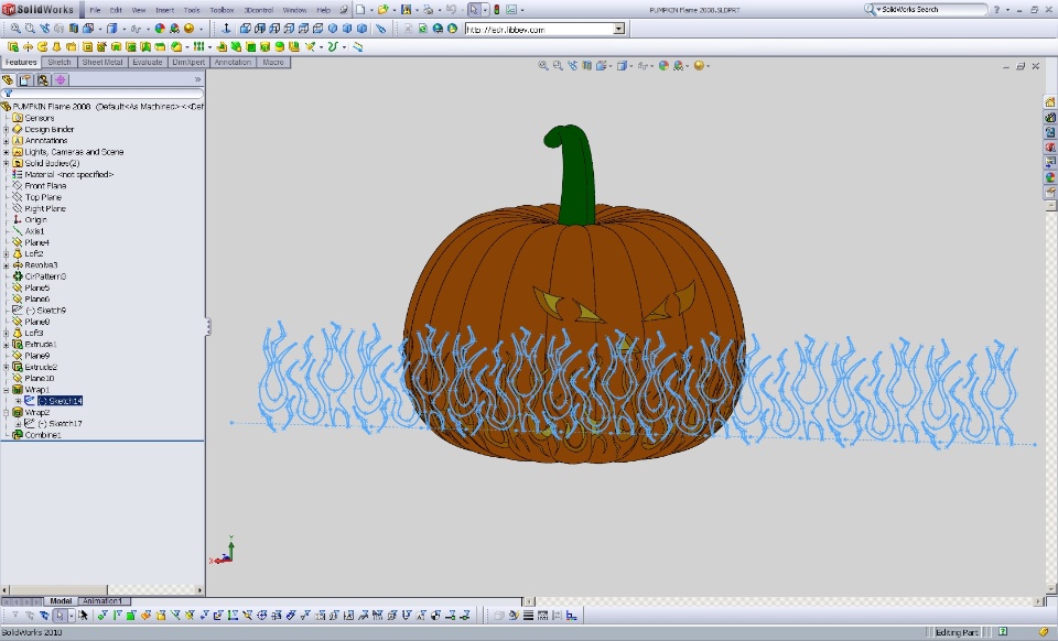

something like this?
comment imagecomment image

I think I had a similar problem.
I created a cylinder around my part.  Wrap and cut it.  Then do a combine/subtract.
Don't know if it will give you what you are looking for.
Example attached.
