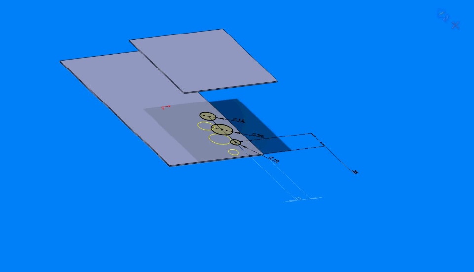

Does anyone know how to make a holes concentric on two different parts.
I am trying to match a hole in a sheet metal panel to another sheet metal panel.  I used to be able to edit in-context a part and have the holes concentric.  I do this to make sure if one hole changes the other changes with it.  Since I upgraded to SW2011,  I am no longer able to do this.  Any help would be greatly appreciated.

Go to Tools > Options > System Options > External References and make sure the Do not create references external to the model option is not selected.

Thank you for responding.  Yes they are two separate parts.  I am designing an enclosure and I start with on panel, add the holes required.  Then I create a new part and insert it into an assembly.  This is where I try to match the holes.

Working in an assembly, I edit a part.  Edit the sketch for the hole (the hole is already on the part) and select the center point of the hole and the edge of the hole on the second part I want to make the edited part concentric to.  I have created holes by starting a sketch on the edited part and converting the entity of the hole I would like to be concentric.  both ways work well.

     I finally figured out what I did to make the holes of two separate parts concentric.  First, I isolated the two parts in my assembly.  Then I edit the part I would like to make the holes concentric to the other part.  I then edit the sketch for the hole select the point for the hole and then I select the hole on the non-edited part by holding down the shift key and selecting the hole.  This will allow you to make the holes concentric to each.  This will ensure when the hole on one part changes, the other part will change automatically.  The only down side is that it doesn't work both ways. One part will have the hole dimensioned to position it and the other hole will have the external reference positioning it.  The Hole with the external reference can only change if the the other parts is relocated or you break the reference.  Hope this helps.
