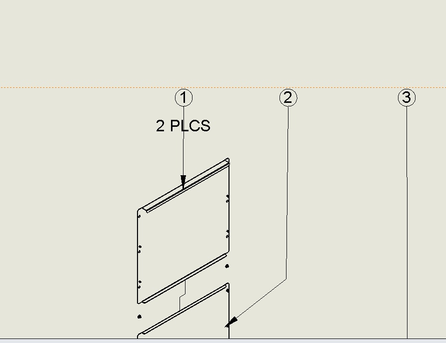

Does anyone know how to change bubble line length when (2 PLCS) are below?
I'm trying to figure out how to change the bubble line length so it doesn't overlap (2 PLCS) below

Why not put the text beside the balloon instead of below it?

Yes your right, I can do that, but there are other bubbles that I need to make space for
as well

You can convert that bubble leader into multi-jog leader and then can bend the leader around
This could be a nice enhancement request too for automatic breaking of the leader if text overlaps.

Yes, I know I can do that as well. I am looking for the correct way to fix this problem. I may have to go into my document properties/dimensions

I'm not quite sure what you are asking for, given the above answers don't work for you.  However, there is one option that might be useful for you, if you are using SW2014 or newer.  In the balloon's PropertyManager in the Leader table, you can choose to break the leader around the QTY or force the leader to attach to the balloon regardless to QTY.
