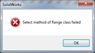

Does anyone else have problems with SW2014 and Excel2013?
Does anyone else have problems with SW2014 and Excel2013?  They don't seem to play well together...
I often get this error when opening a design table and it locks up both SW and Excel. I have to kill both processes, which means I lose any changes made in other excel files I may have open...
-Kyle
SolidworksConfigurations design Tables

That combination has been working fine for me. Maybe it is a software/hardware issue on your individual computer.
KL
KL 2014-11-03
I've found that this only happens when other excel sheets are open... And It's the 2nd or3rd time I've opened the design table in a row...
I try to close excel before editing, that usually works, but it never happened before we upgraded to Excel2013.

I have had issues with things like copying the material from one row to the next causing it to error out when I exit Excel, and loosing all the changes. But I have not had issues with errors launching. I have had other excel spreadsheets open when I open the design table. I have also noticed that opening the design table usually opens excel in a blank sheet too, so I have to close it twice. Never an error message at this point though.
Maybe you need to reinstall Excel or SolidWorks.
SF
SF 2014-11-08
I did run across this a few times when we had Excel2013 but I couldn't trace the issue.  so I'm not much help there.
BUT, I can say do not even think about going to Office365 and running SW with it.  We are still on SW2013, but it doesn't want to work with 365 unless you only want to have your design table open with no other Excel activity going.  Don't leave it open too long or forget and start another instance of Excel and your locked up. Hopefully a new SW will help.
