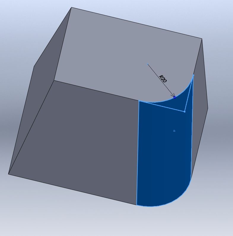

Does anybody know how to add disk fillet with fillet options?
Hi!
I add Fillet shape with Sweep cut chosen "Keep nomal Constanoption" as shown the picture.
I want to add this fillet with Fillet function not Sweep cut.
Is there any fillet option that I want?
Please tell me

what is Disk fillet in your term?
Will u share you model with cut sweep so I can check the similar fillet command ..

In case you face are inclined or have draft then your fillet also come inclined. So if you need to have your fillet straight and not inclined, I believe you'll have to use cut extrude or sweep cut only. Else upload your file as Satish stated and one can look at that.

"So if you need to have your fillet straight and not inclined, I believe you'll have to use cut extrude or sweep cut only."
The answer is what I really want to know.

No, there is no direct method to do that. As you used, Extude cut and sweep cut are the methods

Because, I want to get the answer what was "There is no fillet opsions to do the model."
So I want to choise the answer  for two.
As you say, the replay from Deepak has more detail....
Thank you, Dwight!
And also I would like to add one more method which is Loft cut
