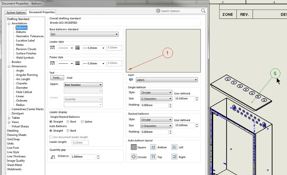

I've got a saved drawing template that I saved along with the text formatting, colours etc but they never match whenever I place an item down.  Example is the baloons, I've got them in RED but when I place them down it's in GREEN and neither does my layers match the document properties either!

Make sure the active layer is set to "Per Standard" prior to placing your annotations and Color Display Mode is not depressed.

I'm using SW2016.
I can't find color display mode not even in the search command - don't know if it's removed in 2016?  Perhaps it not depressed at all.

It is in 2016 also. Go to Customize and check line format to bring up that toolbar. Then see if it is depressed.

thanks, found it.. it's not depressed either.
Pardon me..but it seems of behave now
thanks a lot

Sometimes you have to slap it around a bit to get it to behave. Another thing that can screw this up is the Set Next Line Color. Pen with colors under it.
If I set it to some odd ball color then new balloons I place will take on that color. I have to set it to Default to get my annotations to behave. Very confusing.

It's not really all that confusing.  Layer settings will override document property settings, and Line Format settings will override both of those.
