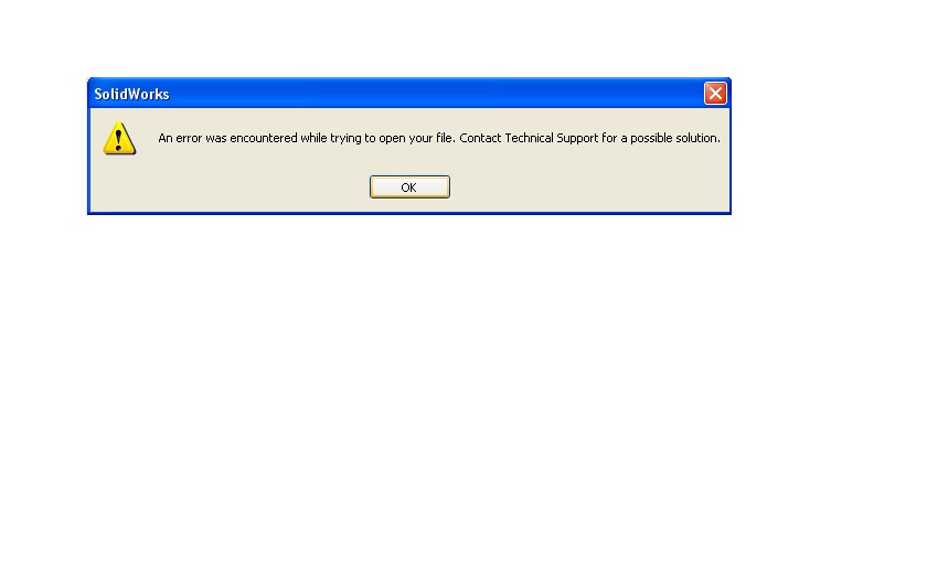

I was creating a drawing out of model and when tried to save it said file is corrupt and can not save. So I saved as a different file under different location. It let me save the file but now when I am trying to open it, it gives me this message. I contacted solidworks support and they say that they do not know what would have caused it. Does anyone have any idea on how to recover hours worth of work back?

Corey,
I would run the SW Rx tool and send that file to your var for them
to forward to solidworks to evaluate.
https://forum.solidworks.com/docs/DOC-1207
PV
PV 2011-06-17
You can either do what Scott suggested, if it can wait for anywhere between months and the end of time.
Else you can see if you got lucky and that perchance you can find a version of it in either in the AutoRecover folder or in the Solidworks Backup folder.
I sure hope that either of those 2 places have something that prevents you from having to do hours worth of work.

I could not find anything under Autorecover folder and unfortunately my back up directory was not in options.

I have allready sent file to technical support but like Peter said it may take uncertain time.

The best will to be make a new one in case you can. Other thing to try out might be to try opening the file with SolidWorks viewer or e-drawing and check if you can take a print or make PDF for reference.

The only other thing I can think of is if you work off of a network
to check with your IT department to see if they have backups.
