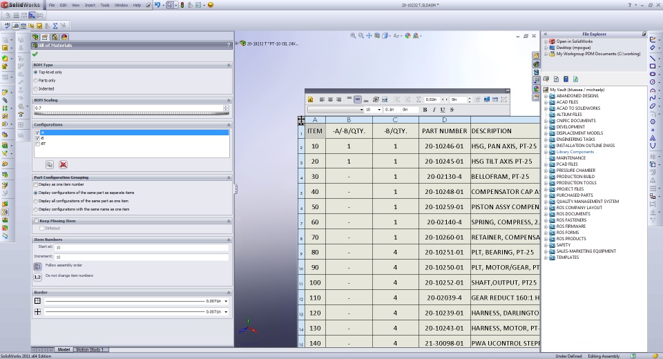

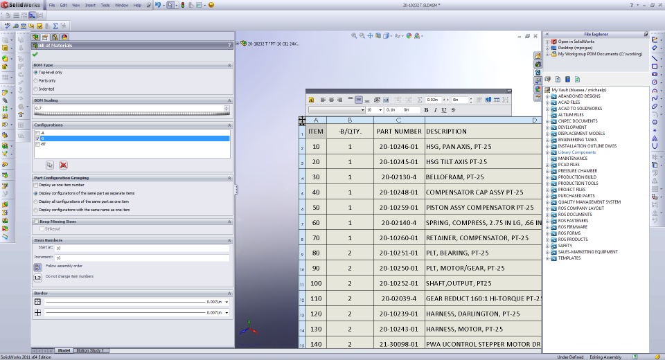

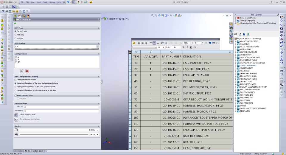

I have a bom with a dissolved subassembly in it. When I am in the -B configuration, the quantities display correctly. When I am in the -A configuration, all of the components of the dissolved assembly display as no quantity. In a possibly related matter, the column heading when in -A displays "-A/-B". Three screen shots are attached.
Some extra notes: the dissolved assembly is defined within the top assembly.
Also, Workgroup PDM is not recognizing and checking out the components of the subassembly.
