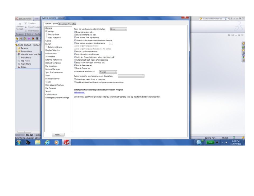

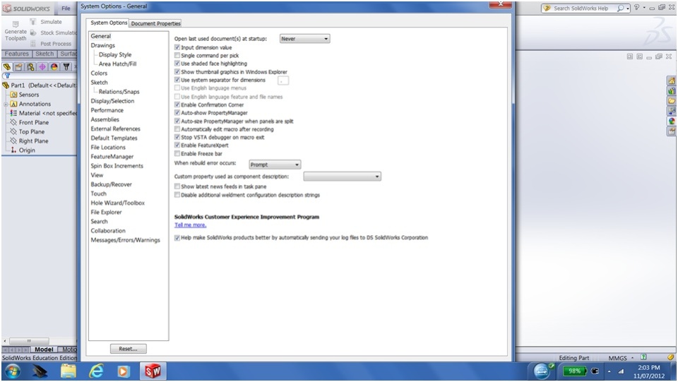

I have just installed SWx 2012 on a lenovo W510 (Win 7 x 64) to replace my SWx 2011 installation. The download and installation went well, but there is a display issue with SWx 2012 that did not show up in SWx 2011. The inserted picture shows buttons in the Options menu blanked out as if the display is too short in height. This did not happen with SWx 2011.

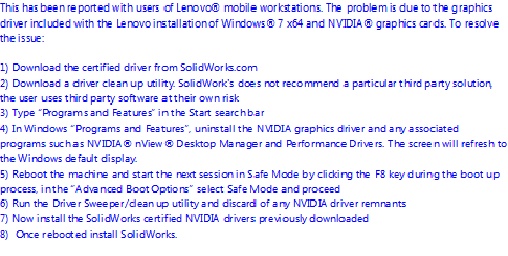

I follwed the instructions posted on the Knowledge base concerning issues with Lenovo mobile workstations.
The only thing that I did not do was install SWx as I have already installed it, so I did a repair of the installation.  That did not repair the display issue.
Should I uninstall SWx, wipe the registry settings ( did not do it for the 2012 installation), and try again, or is there some other settings that I should be looking for?

I fixed the issue. I had to go into the Windows display settings and reduce the scaling to 105% from the original 115%. Now the display is a bit hard on my eyes. I have no issue on my older W500 with a 1540x1050 4:3 display with the same 115% settings.
Now I have to put in an enhancement request ot make SWx work in a 16:9 display.
