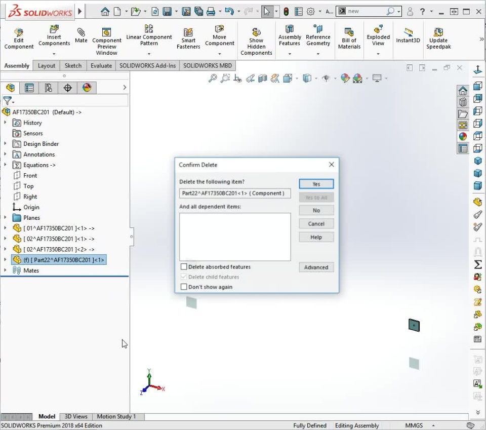

In some assemblies (not all) when I try to insert a new part, the main body of assembly disappears.
A short movie and a sample assembly is attached.
Here's a bit about my situation:
OS : Windows 10 Enterprise x64 with latest updates.
Graphic Card : NVIDIA Quadro K600. Drives are downloaded and installed from here​
SW : Solidworks 2018 SP0.1
Once again, not all of my assemblies show the same result. Up to now I have only two assemblies that can reproduce this.

Hi Habib,
I could repeat the issue on my machine. If I suppressed the Slot feature in the part 01^AF17350BC201 it seems to correct it, but I can't explain why this would cause it. I would raise this with your reseller to try find a fix, maybe it's a corrupt file?
But at least for now you could suppress this and continue with your assembly. You could also make another configuration which has this shown for drawing purposes.
SF
SF 2017-12-08
It seems that you are right.
I deleted and added the slot hole wizard and everything is OK now.
We have sent the file to our VAR. I thought while we are waiting for an answer maybe someone can help us here.
