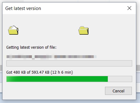

When I try to login to vault, sometimes I got this window "Get latest version" which will get more time to update.
I really don't want to do that. Is it any way to disable it?
Thanks

Under user/group (either works) settings in the PDM administration tool.
De-select *Always work with latest version of files* - i strongly advice not to go with this option though.
