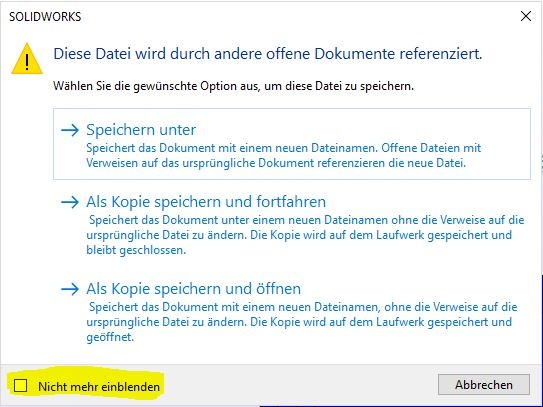

I think it is a necessary Feature in admin Image or in registry to give admins the Chance to disable the "Don't Show again" Button in the popup Windows. Many users klick this button and have no idea that the message did not appear anymore until they delete it in the Options.
If it is possible that admins are able to disable this button many Errors or "strange behaviour" in SWX will not be there anymore.
Save as a referenced part while the assembly is open, then one of the three Options should be klicked- if the dialogue is not htere anymore, the user did not think about what happens next and he replace a part although he will not.

Please submit an enhancement request for this as this isn't part of the beta being that its existing functionality. The dialogue about missing files is a big one that bites our users. They open an assembly with many missing references and check the box to not ask about finding them because they just want to look at something really quick. Then later they call me asking why SolidWorks isn't prompting them to browse for missing files......"because you told it to never ask you again".
