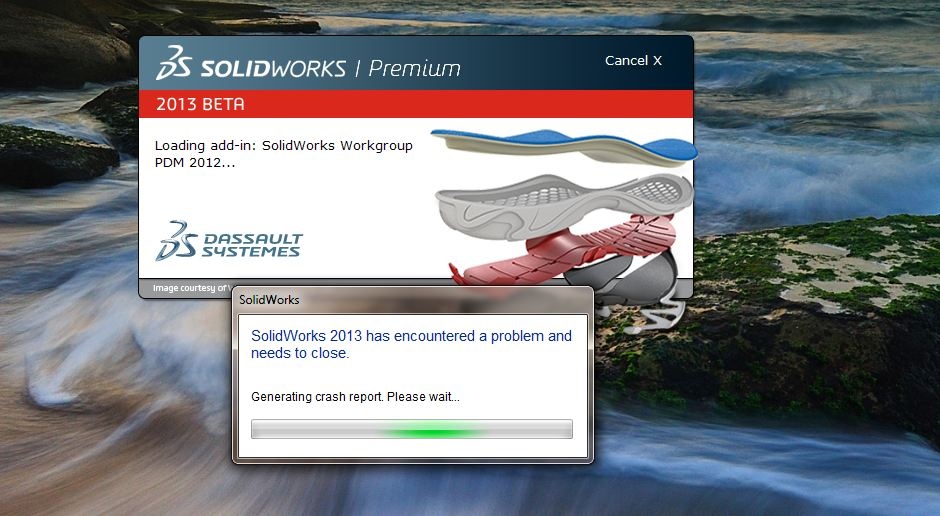

Is there a way to disable the SolidWorks Workgroup PDM 2012 add-in without having Solidworks open? 2013 Beta crashes on the splash screen every time it gets to the point it tries to load the PDM add-in so I haven't been able to open it even for the first time successfully.

I had to go back into 2012 and turn off workgroup at startup.  The settings for what loads at startup is not major-version specific.

Wish I knew about this one....I ended up disabling the addins by editing the regisitry - not the best option but it worked.
