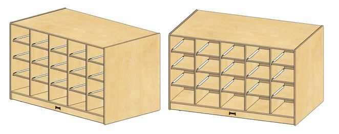

Can dimetric angle settings be altered? I have two assemblies that are virtually identical and when I view them in a dimetric orientation they are at different angles.....what the?? The same happens if I use the view selector. Both models have perspective off and were created from each other...isometric views match on both. I may be missing something really obvious here.

I suspect that the view orientations may have been changed at some time. The view on the left looks more like an isometric than dimetric. It is possible to reassign view orientations. This does not change angles of the dimetric views, it simply reorients the geometry within them. You may be able to change the dimetric view angles on a system-wide setting by using the API to modify settings, but I think that would be more trouble than it would solve.

It appears to occur if you ever float the first placed (and previously fixed) part in an assembly, to say swap it's front to rear orientation.
Once you have made that decision, it appears you are done for.

I am assuming it is in relation to my reference triad being flipped (see attached). Can the arrow directions in the triad be altered without changing the view orientation? I do not want to mess up drawings that have already been created.

If you use the ISO drafting standard the default dimetric view is 42/7
If you use the ANSI drafting standard the default dimetric view is 105/105/150
To switch between dimetric view types 1] switch to the desired drafting standard (options -> doc props -> drafting standard) then 2] reset the standard views (orientation options, reset standard views as shown below).
Thanks to my reseller, DDI, for figuring this out.
More information about the 42/7 view is available here.  The 105/105/150 view is self explanatory when looking at the "comparison of view types" on wikipedia.
