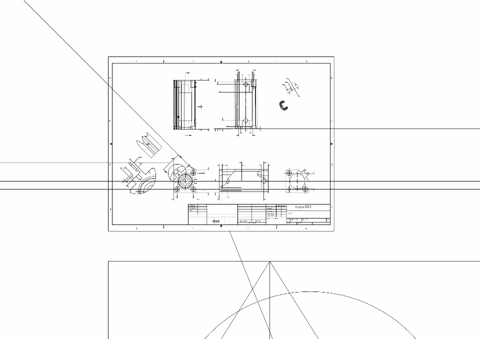

Hi All,
Im still new at SolidWorks. Just installed SW2011 SP2. When i view any of the drawings that i have created or drawings that are part of lessons the dimensions are off the page to infinity? When i box select to delete which works ok and try to add a dimension SW freezes? I thought i would start this on the forum before i make an idiot of myself at tech supprt. I have attached a grab of what i am seeing.

Sorted the problem by shutting the computer down completely and re-booting. Now all the drawing files dimensions are visible. Just som people know if there are missing icons for function on SW UI then the systems needs to be shut down and start again.

Steve, being new to SolidWorks.  Are you aware of the computer requirements?  Sounds to me like you are having video card driver issues or running out of system resources very early, and perhaps you could tell us what you installed SWks on.  Computer Mfg, model, OS, video card, RAM, etc.

At the moment i am running my system on a laptop. I am also running other applications at the same time plus open browser pages to SolidWorks training. I have been interested in SolidWorks for about 14 months now, but this was the first time i have seen all my drawings effected with the same problem. SolidWorks did show a sign of missing quick tips help icon, which says to me that the program may have not loaded correctly. As far as I remember I may have installed add on's or installed a service pack, I’m not sure. Once the system was rebooted completely the program has been fine.
I run a Lenovo W510 i7 laptop with 16Gb of RAM and a certified SolidWorks graphics card. I performed a speed test and logged the results on line on the SolidWorks sites. I'm running Windows 7 64Bit
