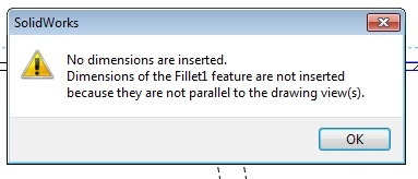

"Dimensions not inserted because they are not parallel to the drawing view"
Hi all....
I'm trying to display design annotations in a drawing view (the dimensions and tolerances defined in the solid model), but for some reason one of the dimensions (the value for Fillet1, in this case) will not be displayed and I get the error shown.    I've even redefined the dimension display orientation to be 90° from the original (ie, forcing it to be parallel to the drawing view), but I continue to get this error.     Any advice?

PM 2014-02-07 Best Answer
Roy,
  In the Property Manager for the inserting of dimensions, select both the checkboxes at the bottom (I think only one is required, but can't remember).  This has worked for me in the past when seeing that message.

Not sure which checkboxes you mean, but I've tried all of the options I can find wiht no change.
One thing I did notice, was that even though I go through the motions of "Changing Annotation View" in the solid model, it doesn't actually update the view (I try changing it from "top" to "front", but the annotation in the solid model file stays on the "top" plane after hitting the check box.....  WTH?)

Any updates on this?   Solidworks 2015 is giving me the same problem.... can't display a round on a cylinder in a section view....

I saw a couple of your post.  It does seem that SolidWorks would want to do this.  Still trying but my workaround is to add an annotation and click the radius dimension from the fillet (no = sign needed).  Still giving me the error for the parallel problem but don't need that dimension now.  If you have a ton of radii I imagine its not that helpful but didn't see that in any other post in case you didn't know about this.
My annotation font in my model is not the same in my drawing but that can be changed in the settings.

@Roy Dean The Problem is in your section view ...check your section line ...i think it might have moved a little from the centre . Hope this solves your problem. Happy to help you  . Any other doubts you can mail me here ddarshangauda96@gmail.com.

I was just having the same issue with a sketch that was creating a chamfer. The sketch was on my right plane and my line was vertical. My fix was to make my line that was creating the section view collinear with the right plane. One other solution that worked was just repulling the section view, so maybe try deleting the drawing view and reinserting it.
