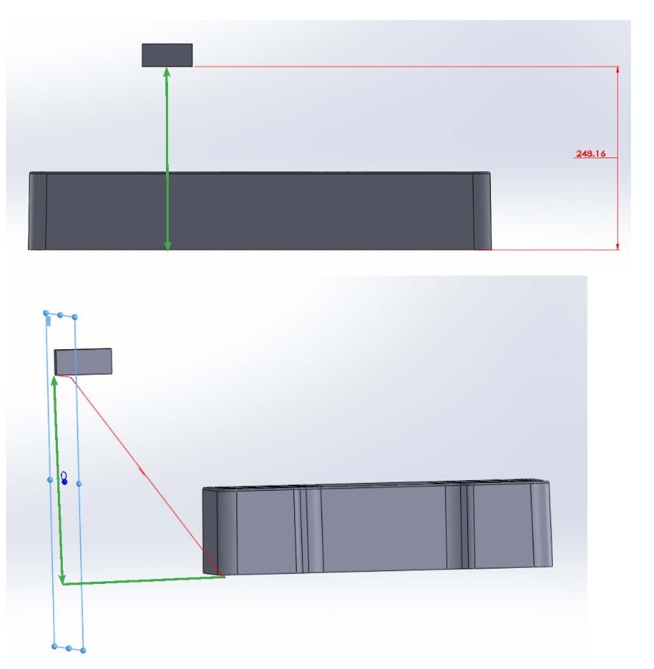

I am struggling when I am trying to insert dims into assembly.
On the image we can see how SW it does. (Red dims)
And I need very often to place dimensions on plane between items (or even edges within part mode)
And I don't know how to do that.
Can someone advise me how to insert dims similar to that green one (on plane) on the image?
Any help will be much appreciated.
Many thanks.

In the assmebly, create a Sketch on a plane that is perendicular to the edges/faces you are trying to dimension.
Convert those edges from part/parts into the assy sketch and dimension between the converted components.

Thanks Alan.
That helps a lot. And I am pretty sure that I can do it in that way also in part mode.
BTW SolidEdge - my previous CAD package has better (easier to apply) dimensioning tool.
In this particular case I could apply dimensions without going to sketch mode.
