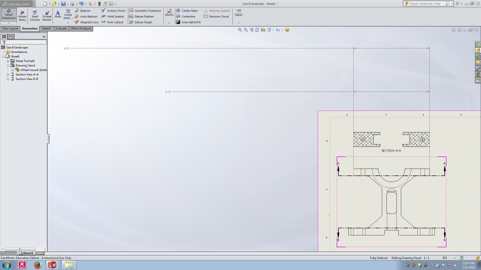

I've been working on something on and off for the past year, and most of the time, I haven't had any problems. Usually, I'll pull up my assembly, and when I want to make an adjustment to a sub-component, I'll just right click the component, open it up, and go from there. Well, one day, my whole body was missing, but my feature tree was still active. I ended up going online and figuring out what it was, and fixing it, but the part has never behaved the same. I'm mostly having minor display nuisances, but the major problem is when i try to dimension things, and it's propagated into my 2D drawings as well.
Here's the issue: When I select my "Start Dimension" tab, and go to select my lines I want to dimension, I can select one, but the second one doesn't highlight. I can select it, but I often don't know if it's selected. Also, typically, when two points are selected, the distance annotation hovers so you can select where you want the leader to be positioned, but it doesn't work for me. Instead, in order to see if I've even selected the lines I need, I have to click, which often puts my dimensions out in space somewhere, which a not-so-fun goose chase ensues. This is especially the case when I'm in my drawings. Often, once I've clicked,  and try to click-off to select something else, another instance of the dimension will appear (in this specific case in the drawings, you will notice that both these dimensions are clear off the page, but I clicked immediately to the right of the far line selected. See attach picture).

JS 2015-07-31 Best Answer
Don't Start Over -
Your template settings need to be adjusted - Set your Tools/Options as shown below then save all your templates with the new settings
