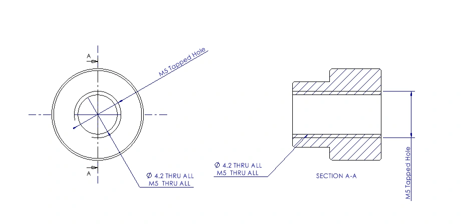

Dimensioning threaded holes changed in 2026?
After updating to SW 2026 1.1 we se a different result when dimensioning threaded holes. When using Smart Dimension, we used to get the thread description e.g. "M8". Now we get "M8 Tapped Hole". This also happens on old drawing we open to edit. Hole call-outs are not affected, work as normal. Is there a setting for this behavior?

AM 2026-02-23 Best Answer
Also see the drafting standard of your drawing template /Annotation > "Show type in thread callouts

This applies to ISO, but not ANSI, so perhaps SWD 2026 is more in line with ISO (than before).
Or ISO, of late, has been changed to this presentation and SWD is just following suit.

Thank you both for the explanation, this seems to be the cause. I will change the setting in our template. Unfortunately it affects all our legacy drawings. Is there a way to make a macro to change this document setting?

Although the SW macro recorder is nearly useless, for recording settings, it works surprisingly well:
Dim swApp As Object
Dim Part As Object
Dim boolstatus As Boolean
Dim longstatus As Long, longwarnings As Long
Sub main()
Set Part = swApp.ActiveDoc
Dim myModelView As Object
Set myModelView = Part.ActiveView
myModelView.FrameState = swWindowState_e.swWindowMaximized
boolstatus = Part.Extension.SetUserPreferenceToggle(swUserPreferenceToggle_e.swDetailingAnnotationShowTypeInThreadCallouts, 0, False)
End Sub
