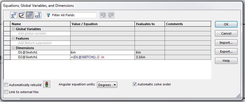

SF 2015-05-26
So I've attached an image of my equations window. And it gives me a syntax error. i've tried all capitalizations, etc, and still it doesn't work. What is the syntax for this? Nothing I do seems to change this.
JF
JF 2015-05-26
use quotes, not parentheses.
