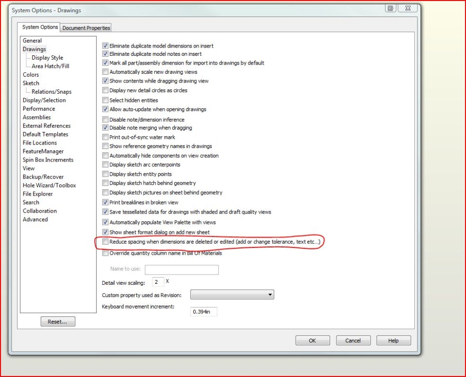

Double check to make sure that you have toggled off the option under SYSTEM OPTIONS > DRAWINGS> Reduce spacing when dimensions are deleted or edited. This helps some but some dimensions still shift position on occasion

Thanks for that John.  I don't have mine checked.  Like I said earlier,
it hasn't been as bad since the first releases of SW2010.
