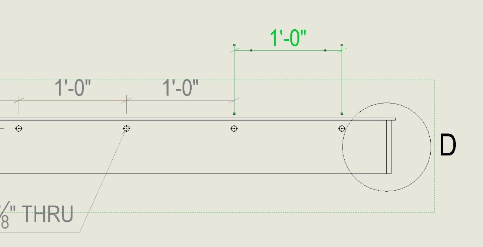

Can anyone explain why the dim line extends?  Is there a setting to turn this fearure off so the line never extends past the extension lines?
See photos attached.  The green 1'-0" dim has the line extended and when I click the green ball on the extended portion it sets the dim line internal of the extension lines....

Craig,
I don't use the hatch marks, but it looks like a dimension when the text is too great to fit between kicks the
arrows to the outside.

I'm pretty sure Scott is right.  I believe this will fix it.  Yours is probably set to the box on the right.
comment imagecomment image

Scott,
Yes, that is exactly when it happens.

SF 2011-12-13
Yes! Thank you!
It was just one of those things that annoyed me and I looked for that setting a while back and just must have glanced over it... appreciate the quick answer!
