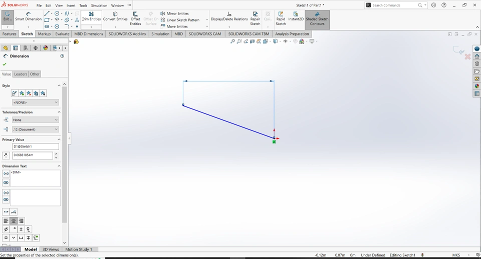

Dimension Error - My Solidwork does not show the dimension. I already delete everything and rei ...
Dimension Error - My Solidwork does not show the dimension. I already delete everything and reinstall it but it's still happen. How can I do now? Can anyone please help me ?! Thank you so much. By the way it 2023 version - Student license
try turning off enhanced graphics performance.
Dimension is set to hidden. Right click on the hidden dimension and click show. See snapshot.
Hello @BL . Try editing the registry as recommended by @KD in the validated answer of this post.
