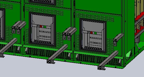

When I open a drawing that was made originally under SWX 2010 with SWX2011, I have some weird dimension bug, like some part are oversize or undersized.
You can see on this picture that the studs are suddenly oversized and they stick out of the panel. I installed SP2 and it did not solve this issue.
Any ideas ?

Is the dimension correct? Reminds me of when I bring things in light weight.

Do the studs have multiple configurations?

Are the studs a toolbox part?  If they are, did toolbox install correctly with 2011?

<p>Mark Kaiser a écrit:</p><p></p><p>Are the studs a toolbox part?</p>
Yes, they are a tollbox part.
<p> If they are, did toolbox install correctly with 2011?</p>
How can I validate this ?

I would start by opening the stud part file, and seeing if the correct size is available.

If they are toolbox parts that have been copied into the job/project directory (or any location outside of the toolbox library) SW may be grabbing the default parts from the toolbox library.  If this is the case, you need to change the toolbox option (new in SW 2011) so that it will get the toolbox parts from the local directory and not the toolbox.
See near the top of this post on how to fix if this is the case.
https://forum.solidworks.com/message/214845#214845
If the job has already been saved in SW 2011, you will have to use the replace command to switch the parts out to the correct models.
