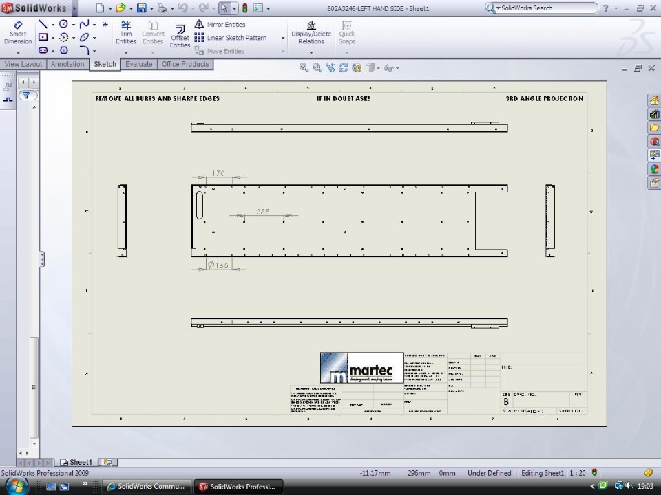

I have various sheet-metal parts with loads of stud-welds iam trying to dimenshion all the stud-weld positions.
The problem i have is on the flat inside part of sheet-metal i can dimenshion the stud-wels centres no problem but the ones that are on the inside of flanges i can only select the inside or the outside of the stud i have overcome this bye drawing a construction line through the centres of the studs but this is very time consuming is there any other easy way to do it.

Can you post an example assembly and drawing file?
I am thinking Hole Charts are the way to go, but can't tell without your models to try.  At least that is what I would do is take advantage of hole charts and model accordingly so I could use them.

Here u go anna i have included the part and assy part with the stud welds
Basically its an electical cabinet with loads of parts lots of the parts have stud-welds i need to make manufacturing drawings for shop-floor.

How are you positioning the weld studs?  Are you using mates or patterns for all the locations?
How about a Sketch Driven Pattern?  Then Show the sketch in your drawing. Dimension to the sketch points that are on center of your weld studs.
You could also add a centerline using the centerline command and then dimension to the center line.
You could also Show the Origin on your parts.  Then dimension to the Origins.
I would be using ordinate dimensions to keep the mess of dimensions under control.

turn on temporary axes (view>temporary axes)
also look into using hole wizard.

Brian, I would use a sketch driven pattern as Anna has suggested.  This gives you all kind of control and it is easier to see later if someone wants to moves some studs around.

Anyone any ideas if there is a good way to automaticly add my dimenshions for my stud-welds i have tryed with turned on view origons then auto dimenshion, it dimenshions everything exept the stud welds on the side flanges is there a way to do it or do i need to just do it manually.
If someone could post a pic or file the right way to do it this would help as i have never done this beforel

You are going to have to go about your modeling very differently to be able to automatically dimension to the weld studs.  Your models current state will not allow that to happen.
I would add some very small holes, with hole wizard, to your sheet metal parts and use them to place your weld studs with feature driven patterns.  I would use a hole chart to locate your weld studs by selecting your hole wizard holes.  For different weld studs I would use a different size hole wizard hole, that way your hole chart will be sorted properly for the different weld studs.  I would then edit the hole chart to call out the weld stud instead of a hole size.
