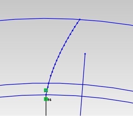

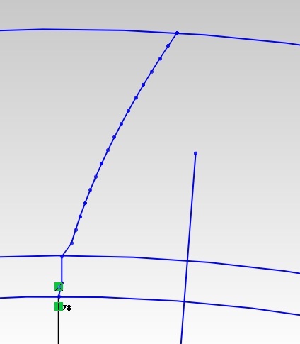

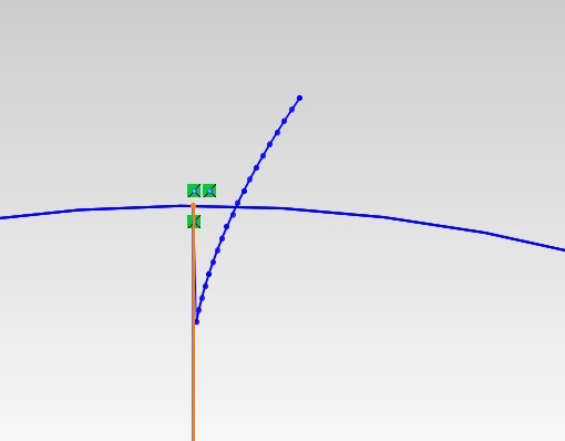

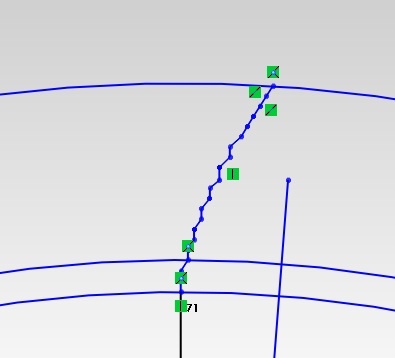

I have the same problem right here. Attached below and example of circles created on two coincident sketches, generated by the same code.
comment imagecomment image
