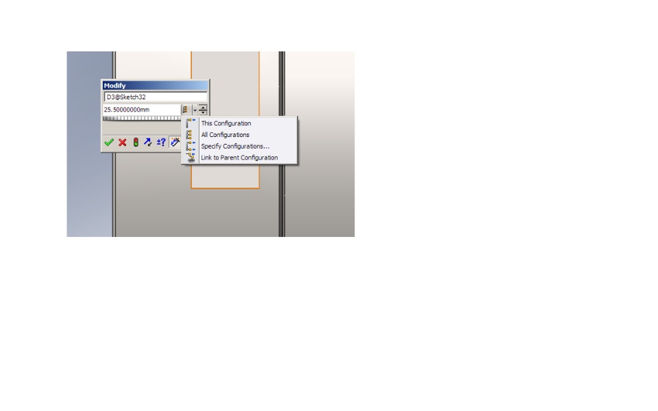

dubble click the dimension of the extrude change the dim, but also select for this configuration only

Apart from manually doing it as Jan suggested, you can also take advantage of Design Tables.

Tim,
The method that I prefer is to RMB on the dimension and choose "Configure dimension" from the drop-down.  That brings up the Design Table that Deepak mentioned.  It will have all the configurations listed so you can set all of them from one place.  You can also double click on other dimensions to set, or on features to selectively suppress.  You can also name the table and save it for later editing.
