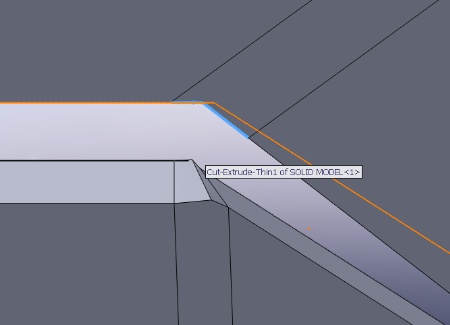

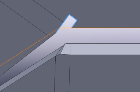

I start off by making a solid model, mirroring it so I have a identical left and right side.
then offset faces, thicken to .1345.  At this point they appear to be identical. I then use the insert bends tool and this is where then ends of the joining offset faces change from left to right?? I've tried using the different methods of relief but its still not the same from side to side??

here is the part, I have since found a different way.  I now go from solid model to base flange tab and for the bends use edge flange, it works better and gives me more options than converting a surface to sheet metal but takes more time…
PS also found that I can mirror sheet metal??  I was told or read that it wasn’t possible..
