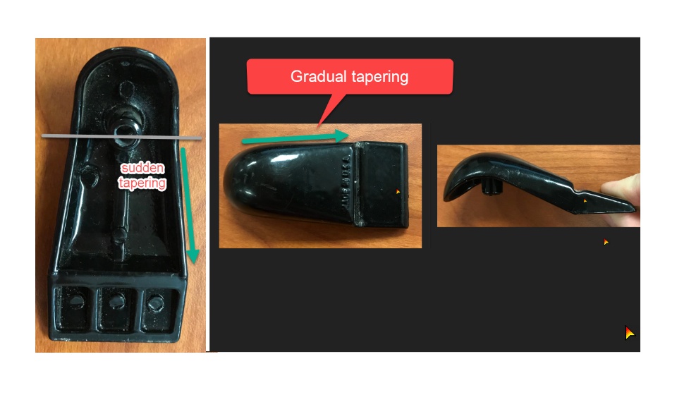

Differences in the Screenshot views
This is screenshot views of a part. I got it from the forum but I do not know the link. I wish to make a part like this. But bottom view shows there is a sudden outward tapering whereas top view shows gradual outward tapering.
Can you see this?

RE 2021-04-08 Best Answer
Hi Maha
Look at the depth
There will be perspective to account for in a photo

John Stoltzfus wrote:
The illusion has to do with the the large curve radius on the top and the small sharp radius on the bottom.
It is a good point.
JS
JS 2021-04-08
The tapering difference that you are noticing is an optical illusion, is my guess.  The illusion has to do with the the large curve radius on the top and the small sharp radius on the bottom.  A part like this would have a draft so it can be a plastic injection part..

I agree with Rob,
Also, the 'top bottom view' is not the true, if it were, you'd not be able to see this side of the boss.

WP 2021-04-08
and there could be extra tapper transition over TOP/BOTTOM in direction of the arrow shown
