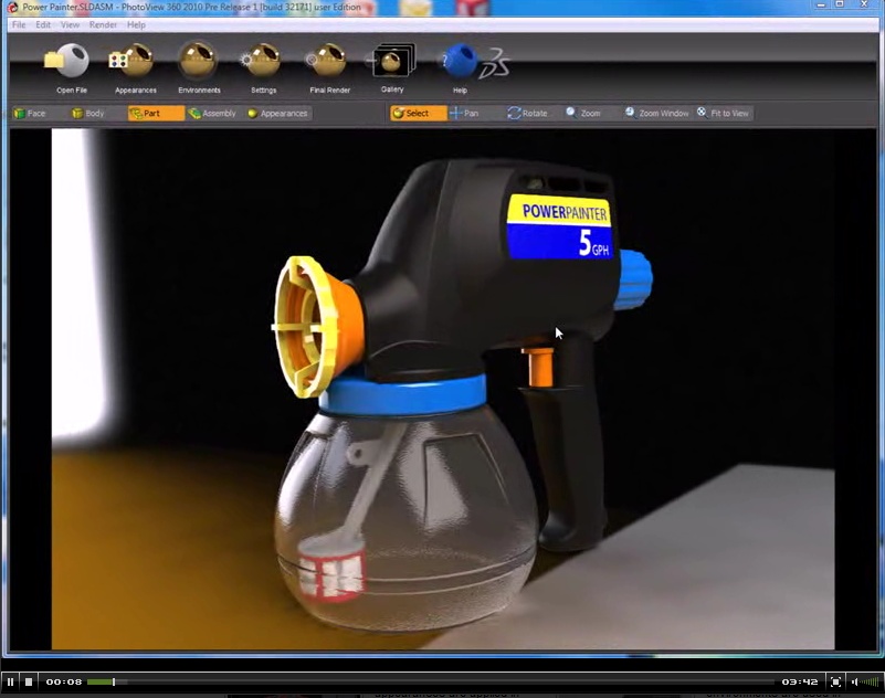

But I have discover there is additionally some kind of "plu-in", I guess, to be precise, I'm refering to next picture:
I'd like to download this plug-in. I'm willing to work in such an environment.  Does anybody know where to download Photoview 360 plug-in ?????

In SW2010 PV360 was a stand alone product.  In SW2011 it is integrated into SolidWorks.  There is no stand alone plug-in.

But then... I cannot understand.  Apparently, the Stand alone product was much more flexible, intuitive, easy and quick, if we compare to the photoview 360 tool bar in Solid 2011  !!!!!
Do you really mean that tools I have snapshotted from my screen here below, is the only way of working now  ???
If so, I might be missing something, because it really seems to have much less functions, options, etc...

Actually you will have the same tools in 2011 that you had in 2010 plus ability to add Lighting, Cameras, create rendered animations. We couldn't do anything with Cameras and Lighting in 2010 PV360.
Appearances and evnvironements work mostly the same. Give it some time and you'll enjoy the interface.
