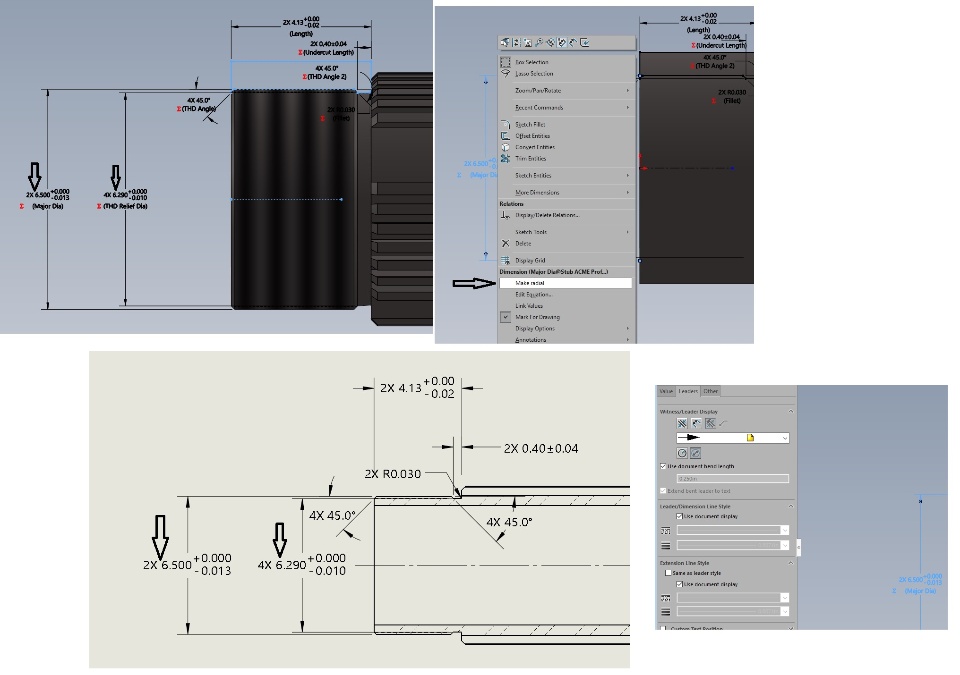

I seem to be having some trouble with the Diameter Symbol not showing up in the diameter Dimensions of features.
This is not the same as the issue ​
I dimension the sketch as a diameter across a centerline and yet the Diameter symbol does not appear in the dimension. Nor does it carry over into the drawing.
I though that maybe a made a mistake and the sketch dimension was recognized as linear instead of diametrical/radial but if you click on the dimension it does give you the option to switch to radial. Also the leader options in the dimensions property manager do have radial/ diametrical selections available
So I would assume that it is indeed being picked up as a diameter dimension
Is there some setting in my document properties or somewhere else that I have forgotten to select/deselect? or anything else I might have missed?
This is driving me bonkers
Using a slightly modified ANSI document property standard
SW 2016 SP 3.0
Win10 Pro 64bit

gtol.sym file does not seem to be corrupted. However, if someone has a confirmed uncorrupted copy of the gtol.sym file from SW 2016 and they could upload here so I could try it out, that would be a great help
That said, logically (?) it should not be a symbol library corruption issue since the symbol does indeed:
  • exist
  • comes up when typing manually in dimensions
  • manually clicking the symbol to add it to dimensions
  • appears automatically as it should in other diameter dimensions of feature sketches (e.g. extrusion boss profile below screen shot)
In the same part file, one profile feature from an extrusion does display the diameter symbol correctly, whilst in the revolved cut feature sketch it seems to not be picked up as per original post.
Below screenshot: if i add it manually symbol appears in the dimensions in question.
below  section of the screenshot, shows existing automatically recognized diameter symbol placed in an extruded boss feature.
both from same part file
So I guess this would imply that it isn't a symbol library corruption (??)
Just thinking out loud.....Is there any chance this could be because the dimensions are linked to global variables ?
comment imagecomment image

To answer your questions:
<p>Kenneth Barrentine wrote:</p><p></p><p>You mentioned restarting SW with no effect.</p><p>Have you restarted the PC?</p><p style="min-height: 8pt; padding: 0px;"></p><p>Is it just one file or all files?</p><p>Is it just with revolves or all features?</p><p style="min-height: 8pt; padding: 0px;"></p><p>Can you attach the problem part or a simplified version of the problem part?</p>
Restarted PC and SW numerous times - No difference
Its any file. Global behaviour. Anything created with current setup has the same issue
It is only with revolved features. For extrusions etc, the symbol appears as normal
Have attached a sample part created from part template. "stock feature" is default in template and shows Diameter symbols as usual.
"test Revolved Cut for Dia symbol" is a revolved feature to show that it does not place the diameter symbol in those cases, despite recognizing it as a diameter/radial dimension as mentioned in OP.
I have also attached my modified ANSI drafting standards, in case the culprit is in there somewhere.
I don't now if the SW setup file would offer any insight either ?
Not sure what else could be of use to you, please let me know

NT
NT 2018-02-07
​ thank you for the trouble shooting there.
I do believe I have found the culprit after having a thought about what you did.
I have Master Axes in the part/assembly templates.
When you select the "master axis" as the revolution axis in a revolved feature, it is not recognized as a diameter, since , I guess, SW does not "see" it as in situ and therefore, does not place the Dia symbol.
If you use the Centerline created within the feature sketch then the Dia Symbol is placed correctly.
I think that's why it popped up for you when you created it since you, by default, let it use the sketch centreline as axis of revolution.
**Edit: I should mention that the diameter symbol will indeed appear but after the revolved feature is created. In sketch mode, during generation of the dimension, the dia symbol is not present. Once revolve is applied the dia symbol appears.(at least in my particular case) Just to clarify.
Hope that clears things up. Hopefully there might be a Service/enhancement request to make it recognize both?
Thank you all for the help!
