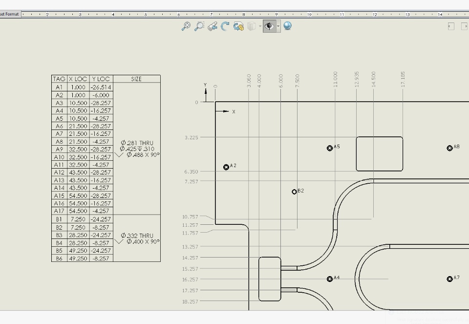

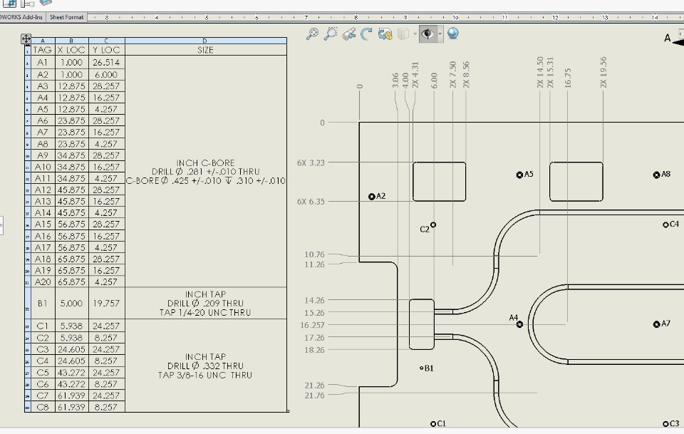

I am detailing a part that I had to create using the Split Function as it was too large for my company to machine in one piece. When I go to add in a hole table, all of my holes read as "dummy holes". We normally have standard call-outs for counter-bored and tapped holes that auto populate into the hole table from the hole wizard in the part model. In this case the split part isn't reading any hole data, only the dummy cuts of the holes.
I have attached two screenshots, one with the incorrect dummy call outs and one with our correct call outs from a regular non-split part.
Is there any way to get hole data to transfer into the split part?
