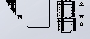

Detail view - Hide other component
When I do detail view on drawing, usually other components are selected because of the selection circle.  It is a pain to hide one by one each line of those unwanted view component in that detail view.  Can you hide unwanted components in one shot? Or is there a better way to do detail view?  Thank you

SC 2017-03-23 Best Answer
Every view is shown in the feature tree. Select the components in the feature tree and hide what you need in the specific view...

Right click on a detail view -> Drawing View Properties-> mark all components you need to hide:
