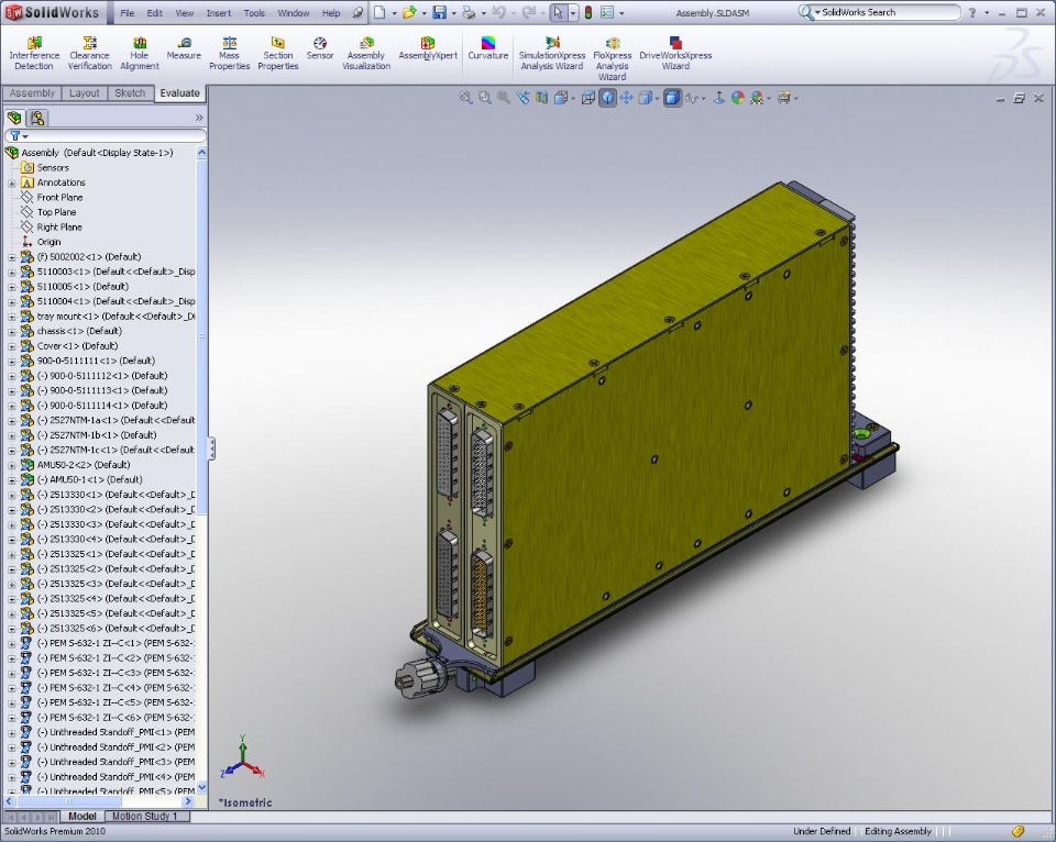

What does the little light blue thing mean by the part in the feature manager design tree? I run Sw on two different systems and it doesn't show up on my other one. I am a new user by the way. I wanted to run a virbration test on this assembly but apparently I can't.

Lightweight.  You can read about it in the Help.  You probably have a setting set that says to open in lightweight.

Really? I opened it in Large assembly mode, Lightweight is grayed out, but it is ticked as well. Odd, can i get rid of it?

K, I can right click on the parts and go to SET TO RESOLVE and it goes away.
Thanks, never seen it before wasn't sure what to do.

If you want to, you can uncheck the Use LAM mode box in the System settings.
