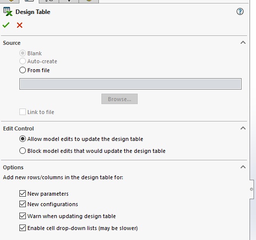

I feel like I'm having issues every time I try and update a design table the changes do not save. This is my Table settings:
I've tried changing Edit Control to block model edits but didn't seem make any difference.
When I leave the edit control to allow model edits to update the design table, I can make the changes in the model and they seem to transfer to the design table properly but it kind of defeats the purpose of having the design table.

GS 2017-12-21 Best Answer
<p>Peter Kennedy wrote:</p><p></p><p>I can't post the part due to confidentiality.</p>
Can you create a sample Part that isn't confidential, and that you have the same difficulty with?

After talking with my VAR they suggested to run a repair of Microsoft office on my computer. I also have Office 2010 and Office 365 which I think might have been the issue, I performed a clean uninstall of all Microsoft Office products using the Microsoft easy tool. I then reinstalled Office 365 which has appeared to have fixed the issue.
