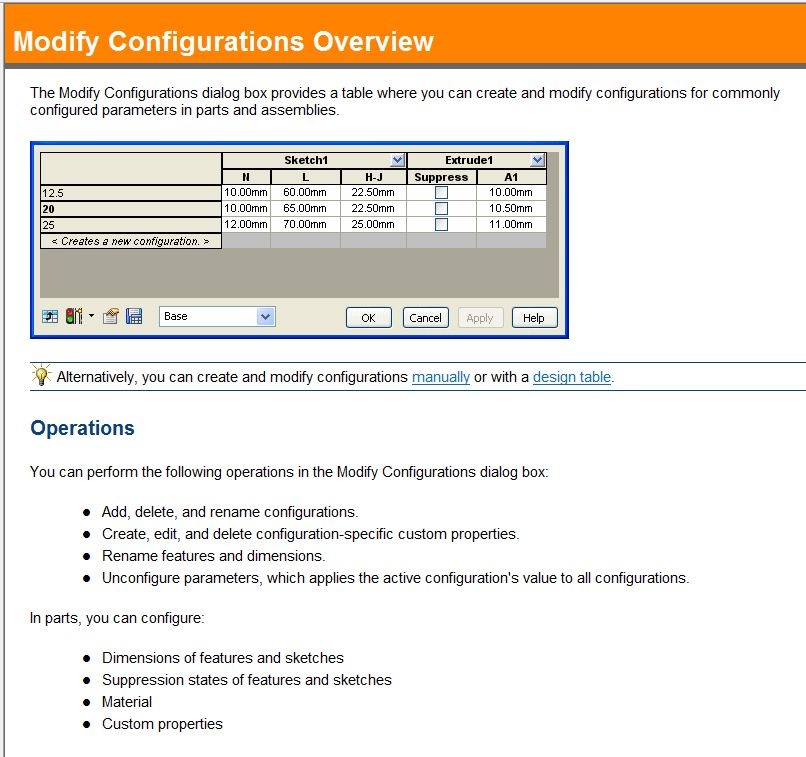

The attached instructions were created a few year back but should still work.
You may also want to look at using the configuration dialog box.  It's much eaiser then a design table but can't be put on a drawing  in 2011 as far as I know.
