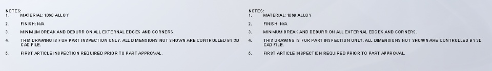

Hi,
I had saved a note (.sldnotestl) to my design library. However, when i dragged and dropped it to my drawing, the spacing is off.
I had to manually activate the note and click the green tick mark for the note to update properly. (CTRL+Q did not work)
*The note is not linked to document font
Any idea why is it like that? Thanks.

I created a note for note library today and has the same issue again, this time ticking the green tick mark did not update the note properly (not is created in SWX 2016).
The note pull out from the design library seem to have different spacing than the manual one created using auto-numbering.

Anyway, i managed to find some workaround (at least for now).
  1. I removed all the empty line spacing that i created manually
  2. I changed the note so that it use the document font and adjust the paragraph spacing instead
It seem to solve the note spacing issue...
But, i will most likely switch to note style as Glenn suggested as I noticed there are other issue beside the spacing (eg: GD&T feature in note will have their link broken)
Guess Library Note is really not suitable for my case....

I had no luck with Rebuild (Note still stay the same after rebuild and even force rebuild)
The design library note seem to not only messed with the spacing but also the alignment i defined... (Note created manually was set to justify bottom but it was changed to top after i save it into design library )
Note styles might be one of my alternative, but updating all my drawing template whenever i want to update the note template seem to be a lot of work...
