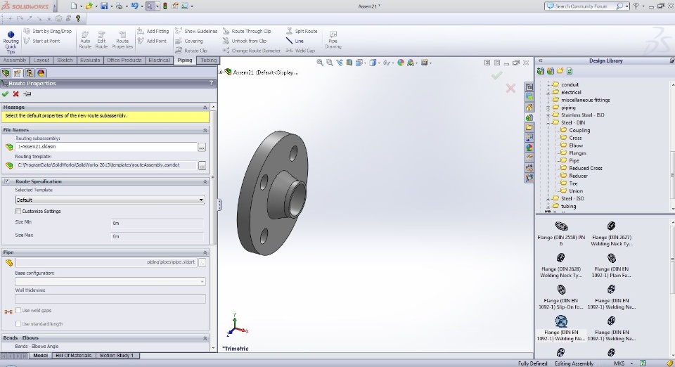

First of all I am new to SolidWorks routing.
I want to build my piping system by DIN (or ISO) std. instead of the pre-selected ANSI.
I have downloaded the DIN library from the design library menu.
SolidWorks -> Content -> Routing -> DIN Piping -> Steel.

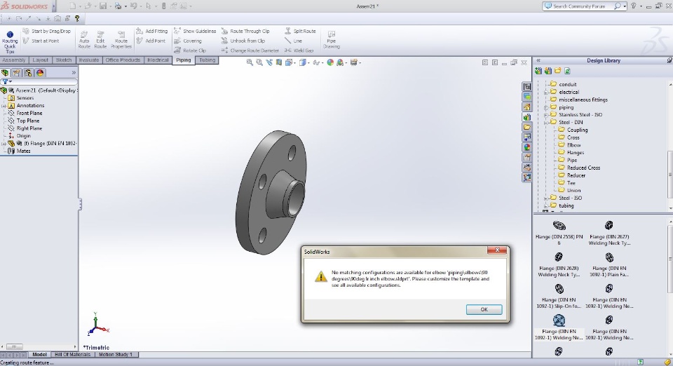

After downloading I have all the cad-parts in a folder, but how do I set up SolidWorks to use these components (flanges, pipes, elbows etc.).
I think I need to make a new routing template but can’t figure out how.
I have attached 3 screen dumps to help you see my problem.
Best regard
Bjarke

You're on the right track! Downloading the DIN library is the first step. You do need to create a new routing template to properly utilize those DIN components. Here's a breakdown of how to set up SolidWorks to use your downloaded DIN piping components:
  1. Understanding Routing Templates: Routing templates control the behavior of the routing tools in SolidWorks. They define things like:
    • Standard: This is where you'll specify your DIN standard.
    • Routing stock: The type of pipe or tube you'll be using (e.g., steel pipe).
    • Fittings: The elbows, tees, flanges, etc., that connect the piping. This is the crucial part where you'll link your DIN components.
    • Rules: How the routing behaves (e.g., minimum bend radius, automatic fitting insertion).
  2. Creating a New Routing Template (Recommended): It's generally best to create a new template rather than modifying an existing ANSI one. This keeps things organized and prevents conflicts.
    • Open a Part File: Start with a new part file in SolidWorks. This part file will eventually become your template.
    • Go to Routing: If the Routing tab isn't visible, right-click on any tab in the CommandManager and select "Routing."
    • Start a Route: Begin a new route. The type of route (pipe, tube, electrical, etc.) isn't critical at this stage as you'll be configuring the template itself. Just choose something to get the Routing tools activated.
    • Access Routing Library Manager: Look for the "Routing Library Manager" icon (it looks like a book with a pipe). Click it. This is where the magic happens.
    • Create New Template: In the Routing Library Manager, you should see a "Create New Template" option (often a button or icon). Click it. Give your template a descriptive name (e.g., "DIN Steel Piping").
  3. Configuring the Template:
    • Standard: In the template properties, select the appropriate DIN or ISO standard if available in the dropdown. If your specific DIN standard isn't listed, you might have to rely on defining the parameters manually.
    • Routing Stock: Define the properties of the pipe itself. You'll need to specify nominal sizes, schedules (wall thickness), and material. This is where having the DIN standard document handy is essential.
    • Fittings (Crucial): This is where you link your downloaded DIN parts.
      • Add Fittings: In the template, add the different types of fittings you need (elbows, tees, flanges, reducers, etc.).
      • Browse for Components: For each fitting, use the "Browse" button to navigate to the folder where you saved your downloaded DIN components. Select the appropriate part for each fitting type and size.
      • Connection Points: Make absolutely sure that the connection points on your DIN components are correctly defined. SolidWorks uses these points to connect the fittings to the pipe. If the connection points aren't set up correctly in the CAD models themselves, you'll have problems. You might need to edit the DIN part files to add or correct these connection points. They are usually defined as "CPoints" in the FeatureManager tree.
      • Mapping: You'll likely need to map the sizes of your DIN components to the nominal pipe sizes you'll be using. For example, a DN 50 flange in your library needs to be linked to the DN 50 pipe size in your routing stock definition.
    • Rules: Set up any design rules you need. For example, minimum bend radius for the pipes.
  4. Saving the Template: Save your template file (it will have a specific file extension used by SolidWorks for routing templates).
  5. Using the Template:
    • New Route: When you start a new route, you'll be able to select your newly created "DIN Steel Piping" template. This will then use the DIN components and rules you defined.
Key Considerations and Troubleshooting:
  • Connection Points (CPoints): Double-check the CPoints on your downloaded DIN parts. This is the most common source of problems. They must be correctly positioned and oriented.
  • Component Properties: Ensure that the properties of your DIN components (like nominal size and material) are correctly defined.
  • Library Paths: Make sure SolidWorks knows where your DIN library is located. Check your SolidWorks System Options -> File Locations.
  • DIN Standards: If your specific DIN standard isn't directly supported by SolidWorks, you might need to manually define the parameters and rules. Refer to the relevant DIN documentation.
  • Testing: Start with a simple piping route to test your new template and make sure everything connects correctly.
