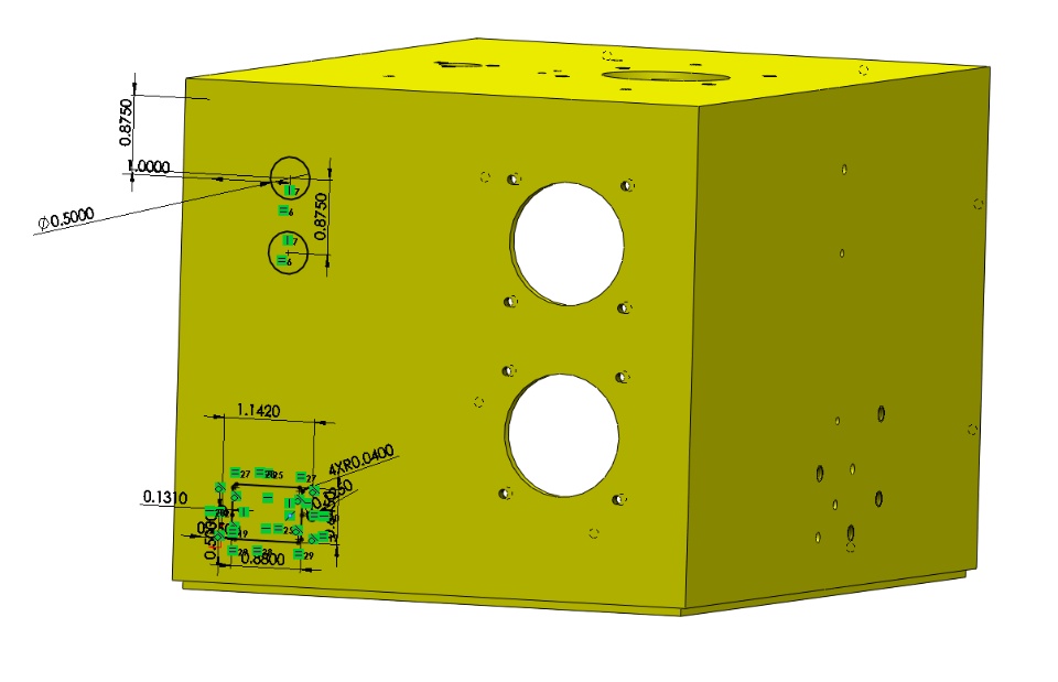

Not sure what I'm doing wrong but I select a sketch by boxing around the sketch to select then depress the control key and select the face I want to put the new sketch on then go to insert but the derived sketch command is greyed out. I want to move the sketch to to the right surface. This is how it is supposed to work, correct?

You need to exit this sketch first. Then select this sketch and ctrl select the face and finally hit derived sketch.

Thanks Deepak - That did it. So you have to be out of the sketch and select the sketch from the FMT?

Yes
