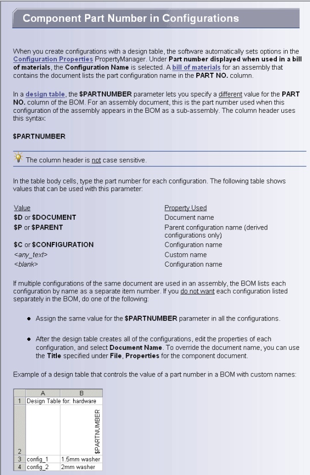

Josh Brady wrote:
By the way, the column header to populate a custom propertycalled "partnumber" would be $PRP@partnumber.
I've used $partnumber for years. See image for SW2007 helpfiles below.
Partnumber is an internal property, not accessable under customproperties that I've discovered. I think it'd be sort of nice if itwere, so let me know how you are doing it.
Thanks
Dwight

$partnumber is what we use to control the part number becauseit's what is controlled by the User Specified Name for the BOM.
