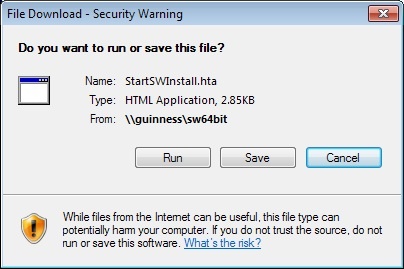

We're about to deploy our initial installation of SW 2010 SP 3.0 and want to notify the users via e-mail using a hyperlink to the StartSWInstall.hta file.  Our e-mail is through Lotus Notes and it is creating an unexpected issue.
Once the user clicks the hyperlink they are given a pop-up with Run/Save/Cancel buttons

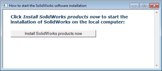

Once the user clicks the Run button they get the usual install from image window

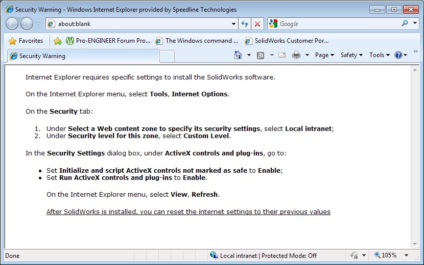

Once the user clicks the Install SolidWorks... button they get a security window from IE.
There seems to be no way to get past this security screen even by making the requisite changes.  The installer works fine if the user goes directly to it and starts it from the image directory so I'm pretty sure it's a bug with Lotus and SW not the actual image.  Has anyone seen this before or have any idea of how to fix the problem?  This has been sent on to our VAR but I've yet to hear back from them and need to get moving ahead.

I noticed in your screen shot that part of the suggested fix is to 'Set "Initialize and script ActiveX Controls not marked as safe" to Enable'...
Even though this is on an Intranet-level, my IMS department would have me fired if I suggested such a thing to our users. Not a good route in my opinion.

For me it works to ignore the warning (third image) an click once again on 'Install SolidWorks products now' (second image).

I did try this method as well but it kept coming back to the security screen.  I've gotten feedback from our VAR and it seems to be a known issue Vista (SPR 436202) but we're running Server 2003.  It may require a new SPR per the VAR.  At this point I've decided to attach a shortcut to the e-mail.  This seems to work fine in the test I've run.  It's not as "nice" as I wanted the e-mail to look but it works.

Solution was to use a shortcut for the .hta file until the issue gets resolved in a service pack.
