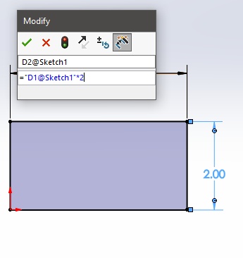

In the past we've used "='D1@Sketch1'*2" had it's update when D1 is changed, as example. Recently, maybe in last 4 months, something has been changed that it no longer updates the dependent dimension when D1 is changed.
Example is a sketch of a rectangle, dimension side 1 at 2inches and side 2 as =2* and click the side 1 dimension. It will calculate initially but if you go back and need to change that first dimension the dependent no longer updates itself. Anyone have a suggestion on getting this to function again. We have many parts that are made in this manner and when updates are made they're not transferring to the dependent variable, additionally to it taking longer to make a dependent variable with new parts.
Currently operation is 2019 SP2.0, if memory serves this change actually happened when we were still running on SP1. I don't believe it was an update issue between Service Packs though.
Entering variable
Initial calculation
Updated D1 doesn't update D2

Yes, it operates correctly so long as the controlling dimension isn't changed at a later point.
I also tried to add a simple Global Variable to control rather which results similarly. When the equations list is opened it's showing as the correct calculation, but the part does not depict that dimension in any fashion (numerically or measure). Thus a 3:1 ratio that has the control updated will no longer be a 3:1. Now adding that part into an assembly, making another part dependent on the first or just creation of DXF for processing through the shop will result in failure.

Just to make sure... Does the equation work when you first make it?
GG
GG 2021-04-08
Yep, that is what I expect to happen, it's just not. Maybe it's time for a service pack update in hopes it might correct equations.
I decided to try a Global Variable, which I rarely use. They won't update either, meaning, adding "a" to be equal to a previous sketch dimension times 1.5 it solves. If changing that 1.5 to 2 and rebuilding it never changes, even opening sketches that use said global and rebuilding them

When I open the file in 2019 SP4, it does indeed open with the equations not updated.  However, as soon as I rebuild, the equation solves correctly as expected.  If I edit the value of the driving dimension while the sketch is active, the driven dimension updates immediately.  If I edit the value while the sketch is not active, the driven dimension does not update until a rebuild.  This is all expected behavior.

Glenn, I updated to have an example part attached. I've used the above equation method on both sketches within. The Boss-Extrude sketch is still solved currently, however the Cut-Extrude sketch is not up to date. It's a simple =dim function but I've change that referenced dim.
Rebuilding does nothing for me in this case, generally I use rebuild rather than check marks just to avoid moving mouse out. Even opening the dimension flyout and pressing the rebuild function within that doesn't update.

Like ‌ said, ctrl+Q (forced rebuild) is a great tool to use anytime you expect something to happen, but nothing does.
JS
JS 2021-04-08
Did you hit rebuild or ctrl Q  ??

For future issues, the solution here ended up being a script that was being blocked by our anti-virus software. After talking with GoEngineer and eventually DS, it was determined a Powershell script being blocked was a likely cause. After whitelisting the Powershell script everything functioned as expected again.
