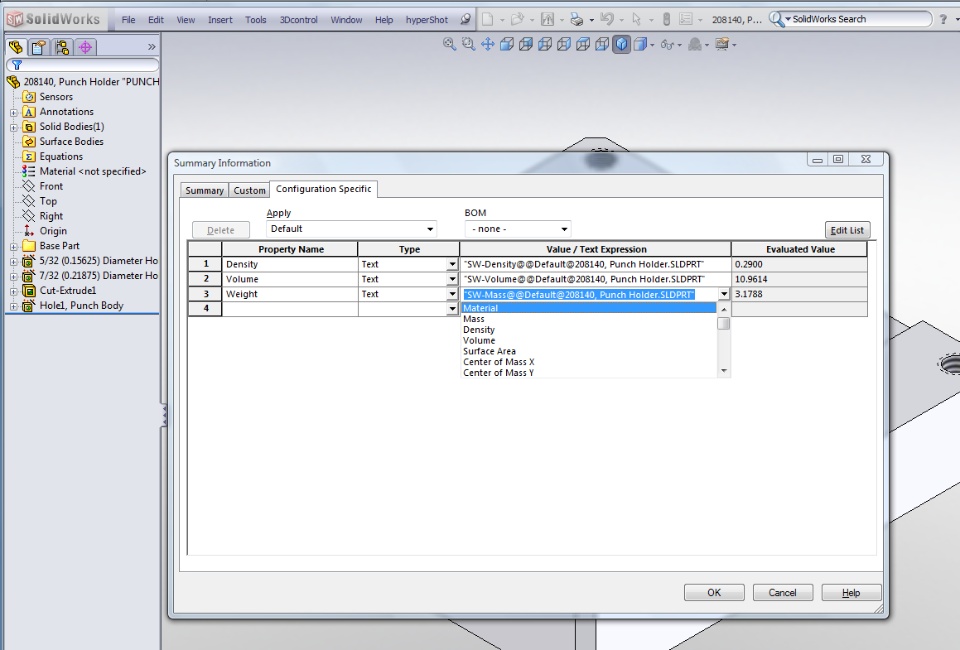

     I'd like to create equation and describe - blank size  x density= weight
how to retrive density from sw automatically from material properties when material is already assign w/o taping it in equation?
SolidworksParts And Features
Answers 6
AW
AW 2009-08-11 Best Answer
Mass is a standard SW Property, if you have the correct density assigned when you apply your material or assigned in Tools > Mass Properties you can link to the Mass.
You can also directly access them in the Equation Editor.
There is also a property for volume and density, plus some more that may be of interest to you.
See attached....

I was trying to do this but sw does not let me do it
Are Y able to telm whats wrong in this equation please
"Material_Weight-per-in3"="sw-density"

Hello,
How can it calculate the mass if it doesn't know the density?
In other words, how I know SW is using the proper density data?
comment imagecomment image
DG
DG 2015-01-30
Increase the number of decimal place(change to 4 decimal places) and you would see the default density being used.
PJ
PJ 2015-01-30
Thank you for the suggestion, Deepak. The answer was in OPTIONS. Also this works
