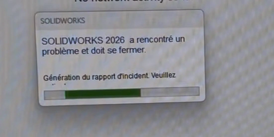

J'ai arrêter solidworks avec le  gestionnaire des taches.
Depuis le logiciel ne redémarre plus et affiche :
I stopped SW using the Task Manager aund since then the software won't restart and displays :

same here

i have the same problem since this morning. New install dosn't help

What can we do ?

this has help me:
Try this workaround by renaming the following DLL:
SWK3DCompassAddin.dll to SWK3DCompassAddin.dll.bak  in C:\Program Files\Dassault Systemes\SOLIDWORKS 3DEXPERIENCE R2026x\win_b64\code\bin\SWXDesktopAddins
Full details are found in this post:

The issue is reported in the BR10000422063
comment imagecomment image

Article ID: QA00000445516
Abstract: Hotfix for user-license versions of SOLIDWORKS® Design installed from the 3DEXPERIENCE® platform (BR10000422063)
Link: https://support.3ds.com/knowledge-base/?q=docid:QA00000445516
