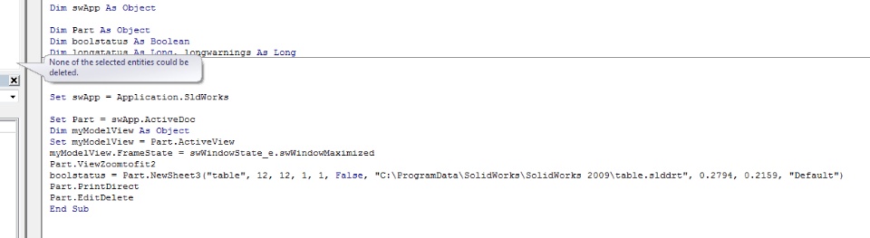

I try to add sheet name "table",and after that go to print,after print I want to delete that sheet,but the screen appear message "none of the selected item could be delete",
and that sheet are still not be delete.Any suggestion?Thanks for any reply.
Select sheet firstly using the SelectById2 and then use ModelDocExtension::DeleteSelection2 instead of EditDelete
Thanks Artem,I not familiar with macro,could you please show more detail how to modify the code?Thanks
