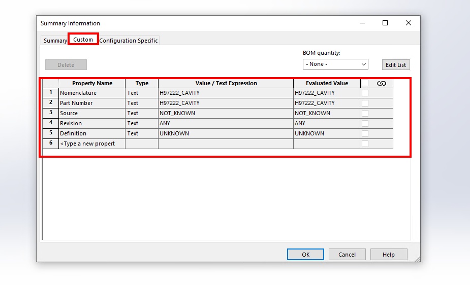

Hi,
I tried to delete all custom Properties in part.
I able to achive with below code. But its working only for "Configuration Specific Tab". May I know how to delete "Custom Tab" ?
Private Sub ProcesssWx(ByRef selectedFilePath As String, ByRef Type As Integer)
Dim swConfig As Configuration
Dim swCustPropMgr As CustomPropertyManager
Dim vPropNames As Object
Dim vPropName As Object
Dim configNames As Object
Dim configName As Object
Try
SWApp = GetObject(Nothing, "SldWorks.application")
Catch ex As Exception
SWApp = CreateObject("SldWorks.application")
End Try
Options = SolidWorks.Interop.swconst.swOpenDocOptions_e.swOpenDocOptions_Silent
Try
SWModel = SWApp.OpenDoc6(selectedFilePath, Type, Options, "", Errors, Warnings)
configNames = SWModel.GetConfigurationNames
For Each configName In configNames
swConfig = SWModel.GetConfigurationByName(configName)
swCustPropMgr = swConfig.CustomPropertyManager
vPropNames = swCustPropMgr.GetNames
If vPropNames IsNot Nothing Then
For Each vPropName In vPropNames
swCustPropMgr.Delete(vPropName)
Next
End If
Next
MessageBox.Show("Error - " & ex.Message.ToString, "AEM Design Center", MessageBoxButtons.OK, MessageBoxIcon.Error)
End Try
saveStatus = SWModel.Save3(swSaveAsOptions_e.swSaveAsOptions_Silent + swSaveAsOptions_e.swSaveAsOptions_SaveReferenced, Errors, Warnings)
SWApp.CloseDoc(SWModel.GetTitle)
End Sub
Thanks
