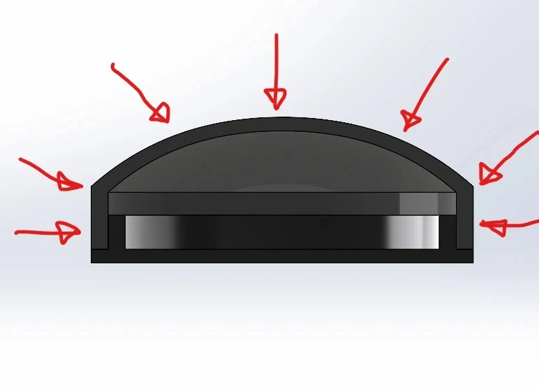

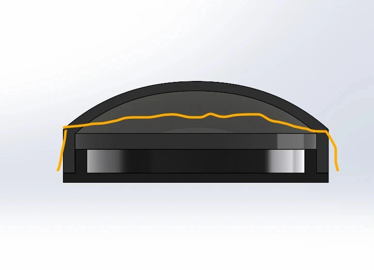

I want to simulate the deformation of a more flexible part attached to a more rigid part. the top is a polymer and the bottom is a metal. I am only interested in the deformation of the softer top part but I want to know the deformation of all surfaces. Ideally no surface of the softer part is completely fixed. The pressure could be applied as indicated with red arrows and the deformation would probably be shaped something like the yellow line but much less noticeable in reality.
How do i set the constraints up in the simulation environnement?

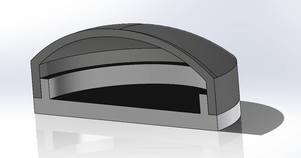

These are cut down the middle.

Hi Leo,
1. What type of study are you going to do, Static or NonLinear?
2. You should set the component interactions to contact. See link below for more info.3. Also take a look at simulation with symmetry. This will reduces the time to calculate the study.
