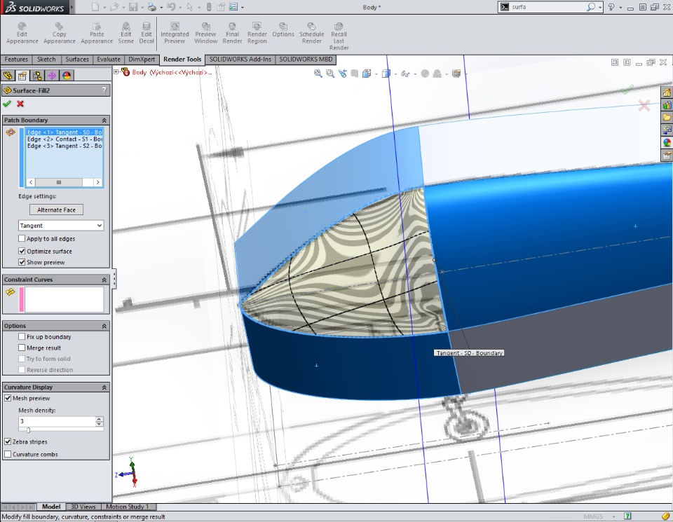

I am in an attempt of modeling MQ-1 Predator according this tutorial: MQ 1 Predator UAV Complete Solidworks Tutorial - YouTube
Unfornutelly, the surfase in the nose section seems to be impropiety filled and I don't know why. All spline vectors are of both tangent and same curvature relation.
Thanks for help!

hmm,.. at ~29:37 he picks Tangent and "Apply to all edges"... so, it should be tangent all around... but.. he and you show Sketch19/edge<2> with a  Contact?..

..don't see your attachment but.. looking back at your image again,.. I see what you selected.. that vertical surface below should not be vertical.. it should be angled to meet/match the end and side surfaces.. (see attached)

The boundary surface seems really as vertical on the picture but is in tangent and curvature realation in fact.

well,.. if that's how the vid shows it (imho, that is not correct).. then you'd change that vertical edge to "contact".. and have the other two w tangency.

The vid workflow seems to me also a bit weired but I've redrawn the model and all look fain so far.
I'll keep going and eventually ask if stumble over some difficulty.
