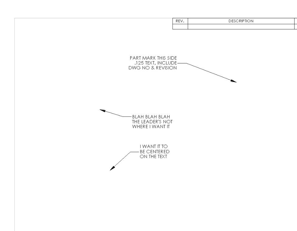

My drawings require numerous notes wherein the leader should be centered.  However, this is not the default.  How can I make this the default behavior of SolidWorks 2008, SP3.1?  I've created a Favorite, but I'm new to Favorites and it is not the default.

CC
CC 2010-10-21
I've tried modifying the text aligment, to no effect.  I've not been able to find a leaders variable.
This image should help.

I am not one to usually publically point out things about SW that I don't like,  but this is one of them.  As pointed out already, you have the opportunity to specify where the leader is attached - top, mid, bottom.  BUT......only if you have at least one hard carriage return inside the note.  If you have used the better dynamic method, then that leader placement does not show up.  So at this point you have a choice of living with what you have with the dynamic, or putting in at least one CR somewhere in the note.

Not quite.  The text alignment does nothing to the leader placment.  I want the _leader_ to attach to the middle of the text, not center the text.

    Yes, that middle radio-button (Attach Leader Center) is the one I need to click so frequently.  I want SolidWorks to place it automatically.  I don't want to finish the note, click the check, then select the note again, just to click that radio-button.
    I could click Apply to All, but that only works well when you're on your last note - which changes where the notes should be placed so a line isn't going through one.
    Is there a way to make SW use a Favorite as a default?

Perhaps sadly, I do not have those options.  I get Text Alignment, Leader Anchor, Leader Style (Straight, Bent, Underlined), and Border.  That's it.  No Leader Position, as I wish there was.
